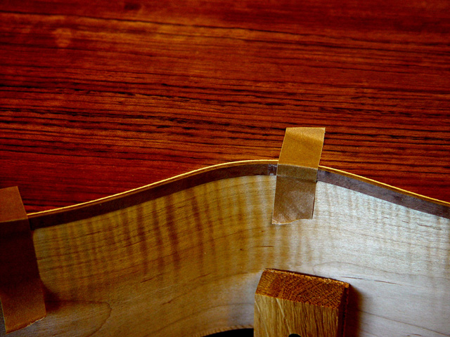

My first guitar has a simple binding scheme with purfling on the back and top, but not on the sides. I'm planning my second guitar now, and want to use a typical bwb purfling on the sides as well. The purfling measures about .100" as compared to the binding thickness of .080".
I'd rather not try to juggle the binding strip and two purfling strips in the gluing process, so can I glue the bwb purfling strip to the binding strip prior to bending? If so, should I try to make the side purfling the same thickness as the binding - and how can I do it?
